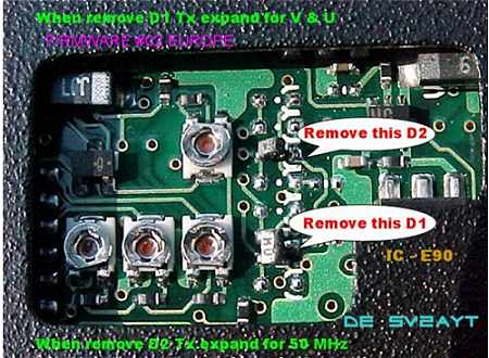

Inserito il 13/02/2016 alle: 16:38:36
iniziamo:
Icom 207H Dual Band Mobil.....
I have preformed this mod on my 2 207H mobil's with success, but doing this
mod is AT YOUR OWN RISK.....
remove the 4 screws ataching the bottom cover and remove the cover. (I had to
 use a small screwdriver to pry on the cover. It's made to fit tight)
with face toward you and belly up look to far right of board and close to you
locate a row of SMT diodes 3 on top then a shift to right and a few more.
The three are in a PERFECT row top to bottom! count from the top of the row
1 2 3. Remove the # 2 & 3 diodes. Now continue looking down from there and
you will see a resistor sticking up in the air (W14). Clip the lead off of
the resistor. Reassemble the radio  and preform a CPU reset by holding the
Set and S.MW buttons while turning the radio on...(page 69 of manual).
You now will have :
    118-135 RX  (stock)
    136-174 TX & RX
    320-399 RX  (hmmm whats there? I've heard a local radio station DJ
             at a remote location talking to the station)
    400-479 TX & RX
    849-950 RX
The Transmitter will work and transmit at ALL of the listed TX freqs. and the
power seems to be fairly broad banded and can handle it...
I now use my mobils as Ham AND GMRS. One less piece to lug around!
118 - 135 Mhz banda aeronautica
Le altre bande sono tutte aperte senza limitazione.
http://www.radiomanual.info/ICO...
Icom IC-E90:
http://komradio.com/e90.html
Aperto in trasmissione sulla nuova banda dei 4 metri 70 mhz radioamatoriale.
Modificato da alva.it il 13/02/2016 alle 16:40:53
