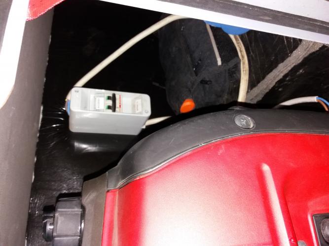

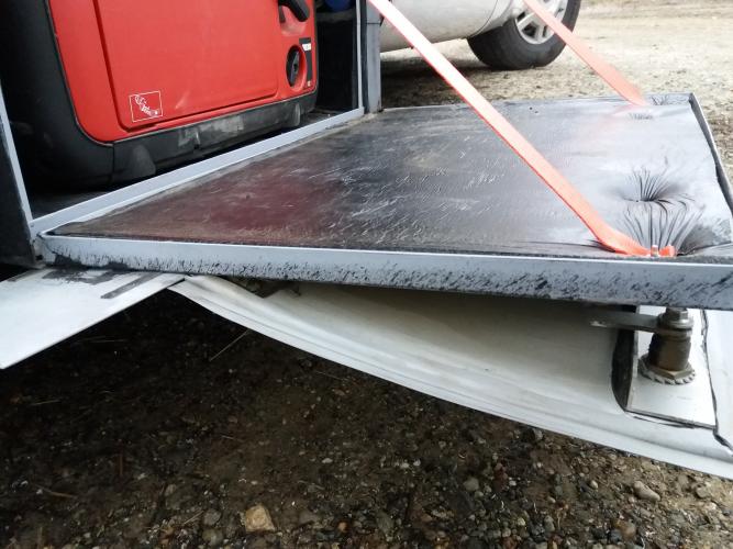

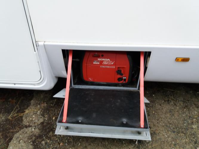

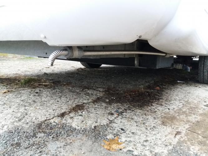

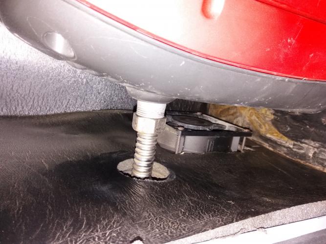

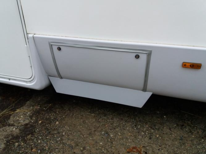

Inserito il 25/11/2017 alle: 09:34:06
20171125_091522.jpg20171125_091502.jpg20171125_091435.jpg20171125_091328.jpg20171125_091357.jpg
