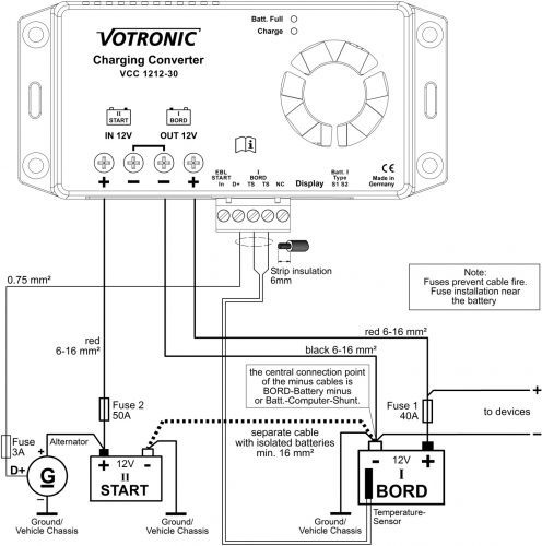

 Votronic VCC 1212 30
Table 1: Recommended Cable Cross-Sections, Cable Lengths and +Fuse Capacities
Configuration of the capacity terminals "IN START + / –" and "OUT BORD + / –":
• The central connection point of all minus cables for units and batteries is the – pole of the BOARD battery!
• If a current measuring shunt in the minus cable (for instance, of the battery computer) is used, the central point of all minus cables is at the measuring shunt, and not at the BOARD battery!
• In case of isolated assemblies, a cable must be laid (see drawing) between the two negative poles of the battery –START und –BOARD with a minimum cross-section of 16 mm²!
• Full charging capacity is ensured, if the cable cross-sections and cable lengths are observed according to the table below!
Questo uno degli schemi di collegamento, loro danno i 16 mm² come ottimale.
La LiFePo4 non l'avrai mai completamente a terra, a meno che tu non abbia problemi…, quindi ribadisco che secondo me questo Booster è un ottimo compromesso tra sicurezza, qualità e prezzo, ti garantisco che in poco tempo la batteria è carica completamente.
